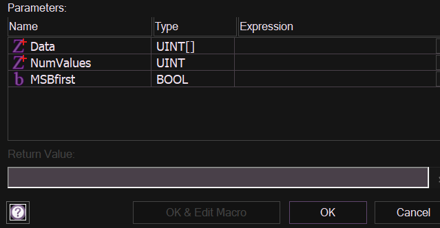

I wrote a simple server and client program to send data from one Flowcode program to another Flowcode program .
It works with strings and byte arrays.
Maybe it will also work with an ESP32 over Wi-Fi. Programs: So strings and byte arrays work, and it would be handy to have type conversion for arrays just like for variable types.
Then it would also be very easy to send and receive integer arrays simply by using type conversion.
