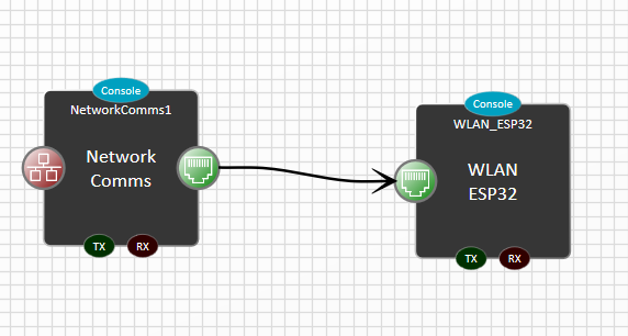

Hi Stefan
No, I meant creating a link using the Network Comms component.
Using it I can connect to my server / whatever and transfer.

Hi Lian
That's what I'd like to have.
I did not realize that I didn't necessarily have to link the Network Comms component.
I tried sending a string from one Flowcode program to another Flowcode program,
on the same computer, using the Network Comms, and it worked fine.

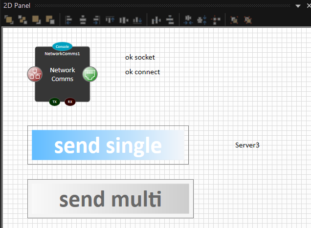

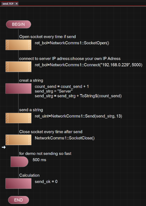

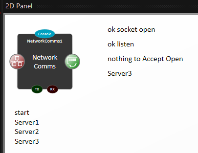

Hi Lian, Hello everyone
I wrote a simple server and client program to send data from one Flowcode program to another Flowcode program .
It works with strings and byte arrays.
Maybe it will also work with an ESP32 over Wi-Fi.
Programs:
TCp_Server.fcpcd
(22.01 KiB) Downloaded 12 times
TCp_Client.fcpcd
(25.95 KiB) Downloaded 12 times

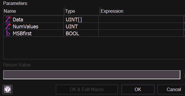

So strings and byte arrays work, and it would be handy to have type conversion for arrays just like for variable types.
Then it would also be very easy to send and receive integer arrays simply by using type conversion.

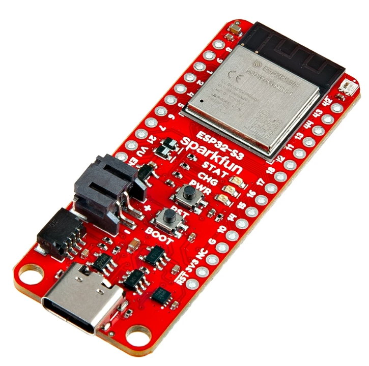

Sending with the ESP32-S3 worked right away.
I just used the macro and added the Wi-Fi
I don't think this easy way is available for the WEB App....
Later, I'll also test the Wi-Fi range
I used a SparkFun Thing Plus - ESP32-S3
Sparkfun_esp-s3_thingspluss1_wifi.fcfx
(23.07 KiB) Downloaded 6 times
