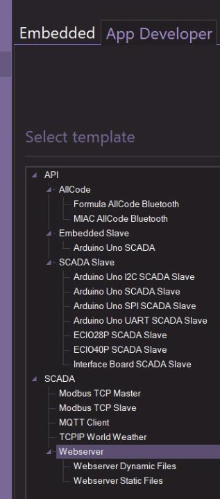

For the App Developer I found some template .
But which of these is for the ESP32?
