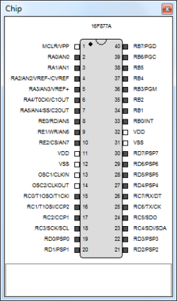

3) Chip View
The current microcontroller is displayed in this window. When the flowchart is being simulated, the state of the microcontroller I/O ports are shown on the microcontroller as red and blue for high and low outputs respectively.
