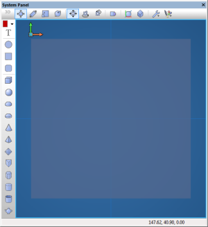

System Panel
The System Panel provides a real-world framework on which to load Flowcode components. It then shows how these components perform during simulation of the current program. It can be customised by adding different background layouts, grids, images etc.

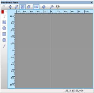

Dashboard Panel
The Dashboard Panel provides another framework on which to load Flowcode components. It is usually used for buttons to control components on the System Panel. It can also be customised by adding different background layouts, grids, images etc.
