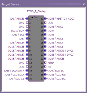

Chip / Microcontroller View
To undock a toolbar simply click and hold on the toolbar grab bars if docked, or the caption bar if undocked and drag the toolbar to its new position.
The current microcontroller is displayed in this window. When the flowchart is being simulated, the state of the microcontroller I/O ports are shown on the microcontroller as red and grey for high and low outputs respectively.
