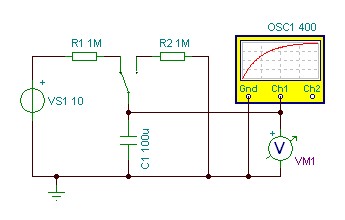

Objective: To investigate the action of a C-R charging circuit when connected to a d.c. supply.
Underpinning knowledge: Capacitance, charge and voltage. Time constant.
Apparatus: TINA circuit file, or apparatus to make the following circuit.
TINA Circuit File: Click here to download circuit file
Initial Settings: C = 100µF, R = 1M&#937;, 10V d.c. Supply.
Requires: Paper, Linear graph paper, pen or pencil.
Instructions:
(a) Change the switch so the capacitor is connected to the voltage supply. Then start the simulation in transient mode.
(b) Take readings of capacitor voltage every 20s from 0 to 200s and then every 50s from 200s to 400s. At each point, measure and record the capacitor voltage in a table.
(c) Plot a graph showing capacitor voltage, V'_C_', plotted against time, t.
(d) Determine the time constant of the circuit (C x R).
