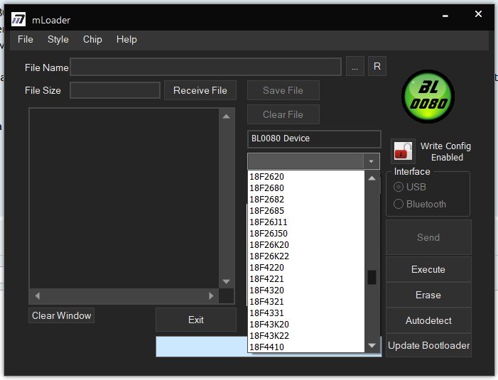

About the chip, may i request you to check if i can use PIC18F27K42 with 0080.

Based on the target list I don't think you can program the 18F27K42 directly in the BL0080 using mLoader (but you could via the ICSP).
Screenshot 2025-03-30 102933.jpg (50.5 KiB) Viewed 4622 times
Maybe someone in Matrix can confirm?

Thank you for the confirmation, lets hear from Matrix Team.
By the way one more doubt, kindly excuse if i sound stupid, what i understand is the i cannot download the program in the said chip directly using "Compile to Target" button, but i can using ICSP instead, but my main concern is debugging, does that mean i cannot use the ghost function too for the said chip ie 18F27K42.

Yes as ChipFrier has pointed out I'm afraid the BL0080 will not directly support reprogramming the 18F27K42 device but can be programmed on the board via the ICSP socket and a programming tool such as the PICkit3.
As far as Ghost is concerned the ICT should work straight away. The ICD should also be fairly easy to get going but may require changes to the chip definition file (FCD).

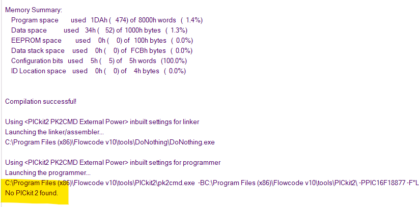

I have already downloaded the compiler, as i am already working using FC10 and able to compile my chart, i also installed the EB2 drivers, i think that is the reason the USB LED is blinking.
I am able to enable and disable the ICD button as mentioned, probably the problem is with downloading the HEX file after compiling. I found the mLoader setup and installed that too and was able to download the HEX file.
Please check the below picture, do you think i need to mention to use the mloader instead of PICKit.
Thank you.

I tried to run a simple program to blink LED but it seams the HEX file is not downloaded, nothing happens, but the mloader downloaded successfully as per the message.
