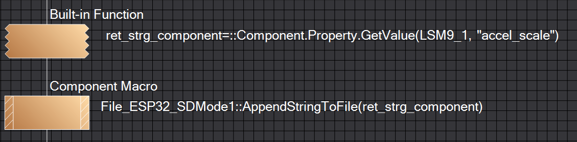

I would like to write the component propertis at the beginning of the Excel file.
Append string works with a text, but not with the build in function created string.
Does it work the way I program it?

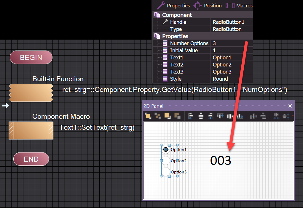

Re: Write component property to sd-card
Hmm this one is a little tricky as you can't directly reference component properties.

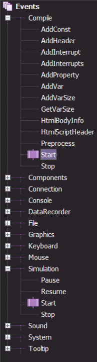

One trick would be to do the following.
1) Click on a blank area of the panel to select the panel and in the properties window create properties to hold the values
2) Add a macro to the Compile Start event and to the Simulation Start event, this can be the same macro for both events
3) Inside the Compiler Start macro copy the value of the property you want to your local property
4) Reference the local properties in your program as you would variables
That should work.

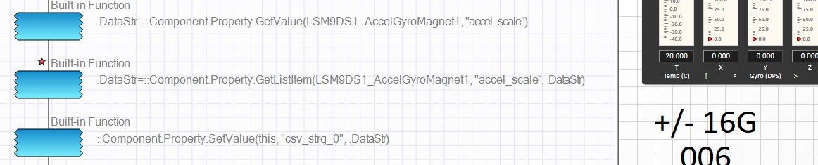

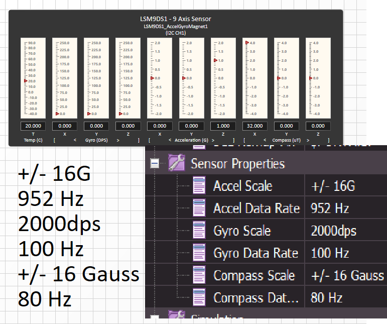

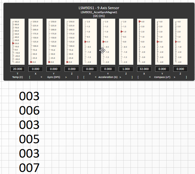

I have tried but I probably only get the index of the switch and not the text of the property
GetValue returns the property value, if instead you want the label string then use the GetListItem function to get the label assigned to the value.

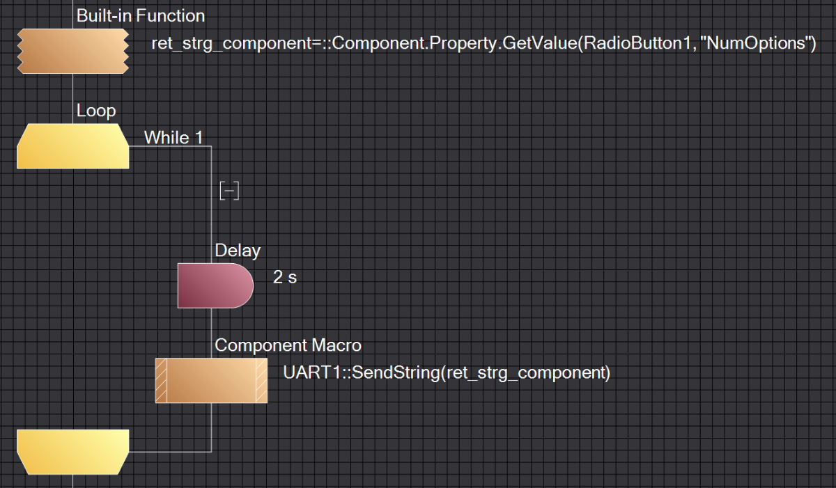

Yes this way is perfect.
Unfortunately working only in the simulation. I cannot compile to hex. There is a fail.

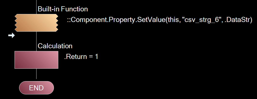

Posts: 1296
Has thanked: 246 times
Been thanked: 258 times
I add but still fail compile to hex. Sim is always ok
