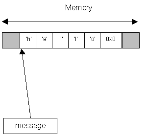

const char * message = "hello" ;
The BoostC compiler will create a string (which is actually an array of course) with the pointer message pointing to the base of it. The string will contain the ASCII codes for "hello" with a 0 at the end. The diagram on the right shows how this works.
Note the word const in front of the variable declaration. This tells C that we will never try to change the contents of this array. The BoostC compiler likes to hear this, because strings like this are held in the Read Only Memory (ROM) on the PICmicro microcontroller, and therefore can't be altered.

string message, is actually a pointer to the first char 'h'
