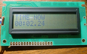

We can look at these by considering one of the exercises we are going to perform with the PICmicro microcontroller. We are going to connect the PICmicro microcontroller to an LCD panel, and create some code which will display messages on it. This code is not an end in itself, instead we will want to use the facilities provided by it. To do this we will package up the program as a file which contains a series of functions which we can call to get things done. We can then put this file in a project with other source files which are linked together to create a product.
The LCD display
