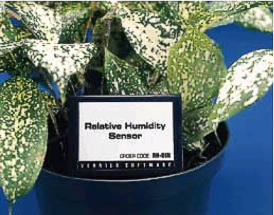

If your sensor produces a voltage or changes its electrical resistance in response to thing being measured you can now use your PIC microcontroller to get your programs to interact with things like temperatures, speeds and pressures.
