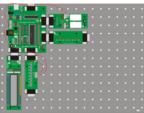

Construct the system shown from E-blocks.
In the course navigate to the ‘Flowcode step-by-step’ and review the section on Software Macro (step 10). The descriptions of the multiprogrammer board , the switch board, the LCD and the led board are in the E-blocks section.
