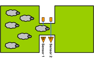

:L7-E10: This is an exercise that counts how many sheep are in both paddocks at all times. The maximum can not exceed 6 and is always shown in binary form on the LEDs of port B. The 4LSB’s are for the number of sheep in the left paddock and 4MSB’s are for the number of sheep in the right paddock. SW0 can be used to simulate a '1' for Sensor 1 and SW1 can be used to simulate Sensor 2. Be aware of sheep that turn back before they are in the other paddock. This is why we need 2 sensors. A sheep is longer than the distance between the 2 sensors. Don't fall asleep! Download this program to the PIC and test it.
