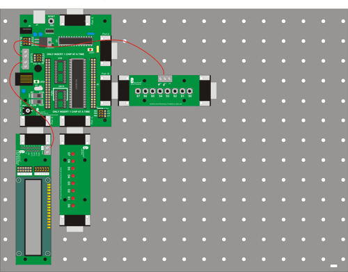

->'''''2. Setting up the equipment'''''
->'''''3. Hardware settings'''''
EB006 OptionsSettingJumper settings (EB006)Jumper settings (HP488)
Power supplyExternal, 14VJ29: PSUJ29: PSU
PICmicro device16F1937
Programming methodUSBJ12,13,14: USBJ20: USB
Clocking methodXTALSW2: XTALS2: XTAL
R/C clock speed
Xtal frequency19 660 800 Hz
LVP Jumper selectionI/O PortJ11,16,17: I/O PortJ15,16,18: I/O
Port A E-block
Port B E-blockSwitch board
Port C E-blockLED board
Port D E-blockLCD board
Port E E-block

Construct the system shown from E-blocks.
In the course navigate to the ‘Flowcode step-by-step’ and review the section on Seven Segment Display (step 9). The descriptions of the Multiprogrammer board , the switch board, the LCD and the LED board are in the E-blocks section.
