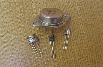

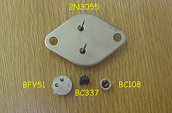

The picture shows four common transistors. These vary in the total current they can deliver to the load, and how much current they take from the PICmicro chip in order to operate. The current gain of a transistor measures how much current is drawn from the PICmicro chip, in this case, for a given current delivered to the load. For example, a transistor with a current gain of 100 needs only a current of 8mA from the PICmicro to control a load current of 800mA.

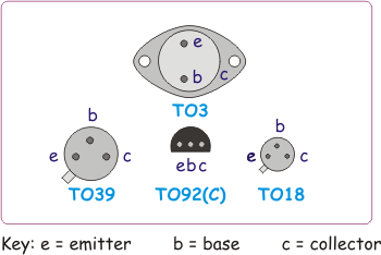

Transistors are manufactured in a number of different packages, some metal cased, and some plastic. To use a transistor, you need to know the pin-out for the package used. The next picture shows details of the packages and the pin-outs for the four transistors shown earlier.
