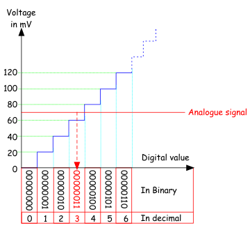

For example, if the biggest analogue voltage is 5V, and the PICmicro has a 8 bit A to D converter:
* the highest 8 bit number is 1111 1111 (= 255 in decimal) * the first step is 0000 0000 (= 0 in decimal) * This makes a total of 256 steps, so each step is a voltage jump of 5V/256,which equals about 20mV per step.
When the PICmicro is told to look at an analogue signal, and convert it, it divides the analogue signal by 20mV, to find out how many steps up the signal sits. This gives the digital equivalent of the analogue signal.
The next graph may make this clearer.
In our example, the converter outputs 0 for any analogue signal up to 20mV, outputs 1 for analogue signals between 20 and 40mV, and so on.
