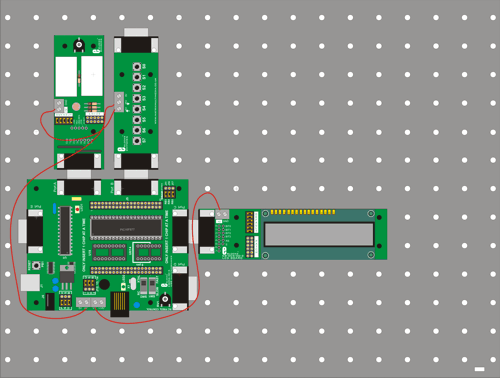

The diagram below shows you the E-blocks equipment you will need for this section:
Multiprogrammer Hardware settings:Setting:
PICmicro Device16F1937
Power supply13.5V
SW1 (Fast/Slow)N/A
SW2 (RC/XT)XT
XTAL19 660 800 Hz
PORTASensor Board
PORTBSwitch Board
PORTCLCD Board
PORTDN/A
PORTEN/A
LVP Selection JumperI/O PORT
J12-14 (ICD2-USB)USB
J29 (PSU-USB)PSU(:nl:)(:table style="clear:both":)
