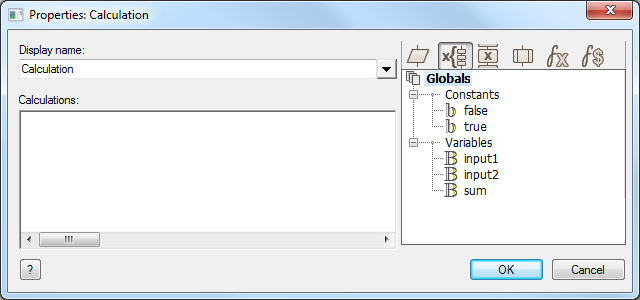

# Double-click on the Calculation icon to open the Properties dialogue box.
# Change the 'Display name:' text box to "Add the two numbers together".
# Tell the Calculation box what it is supposed to calculate by adding the following to the 'Calculations:' box:
->sum = input1 + input2
->You can either type this in directly, or drag the variables from the right window to the box to add each variable in turn, and then add the '=' and '+' signs in the right place!
# Then click on the OK button, to close the dialogue box.
