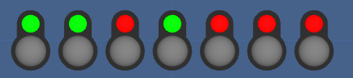

# Now set up two numbers on the switch components. ->Move the cursor over the switch box connected to Port B. ->Click on switches B0, B1, and B3, to activate these switches. The switches should now look like this:
->You have set up the binary number 000 1011 (which is the number eleven in decimal.) ->Switch B6 gives the most significant bit of the number, and B0 the least significant bit. ->Set up the number 000 1111 (fifteen) on the switches connected to Port C.

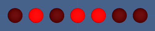

# Press F8 again. The value stored in 'sum' is transferred to the LEDarray. ->It looks like:
->Reading from Most significant bit (D7) to Least significant bit (D0), the LED array shows the number 0001 1010. In decimal, this is the number 26. No surprises there then!
