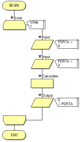

# Launch Flowcode. Start a new flowchart.
# This time we need to take notice of this dialogue box:
->We need a PICmicro chip with at least three ports. Pull the slide bar down to find the 16F1937 PICmicro, Click on it to select it and then click on OK.
# Click and drag a Loop icon between the 'BEGIN' and 'END' boxes.
# Click and drag an Input icon and drop it in between the ends of the loop.
# Click and drag a second Input icon and drop it in between the ends of the loop.
# Click and drag an Output icon and drop it just below the 'Input' boxes.
# Click and drag a Calculation icon, and place it in between the second Input icon and the Output icon.
# Your flowchart should now look like this:
