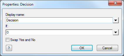

# Double-click on the first (upper) Decision icon to open the Properties dialogue box.

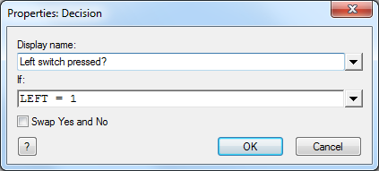

# Type "Left switch pressed?" in the 'Display name:' box.
# The program makes a decision based on the value stored in a variable. ->We spell out what that decision is in the 'If' box: ->Delete the '0' in the 'If' box. ->Click on the button next to the Variable box . ->Double-click on 'left' to insert it into the box. ->Type "= 1" after the word "LEFT" in the 'If' box (LEFT = 1).
# The Decisions properties box should now look like:

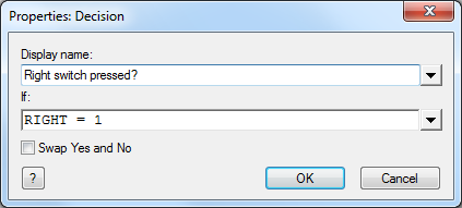

# Double-click on the second (lower) Decision icon. Set up the properties as shown in the next box:
