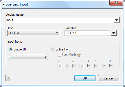

# Double-click on the first (upper) Input box. This opens the Input Properties dialogue box.
# Type "Check the left switch!" in the 'Display name:' box.
# Click on the button to open up the 'Variable Manager' dialogue box.
# Hover over the variables label until the appears. Click on it, then click 'Add new'. ->Create two variables, called "LEFT", and "RIGHT". ->The 'left' variable will record whether the left indicator switch is pressed. ->The variable 'right' will record whether the right indicator switch is pressed.
# Click on the 'LEFT' variable to highlight it, and then click on the 'Use Variable' button.
# This takes you back to the Input Properties box. You will use Port A as the input port. Click on the 'Single Bit:' radio button, and leave the selection in the box next to it as 0. This means that only the value of bit 0 of Port A will be transferred to the variable 'LEFT'. This means that 'LEFT' will always be either a 1 or a 0.
# Click on the OK button to shut down the Input dialogue window.
# Now double-click on the second (lower) Input box. Set up this Input Properties box in a similar way, to look like this:
