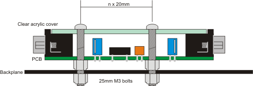

These are mounted onto E-blocks with 25mm M3 bolts and 10mm spacers using the same grid of holes that are used for mounting the E-blocks to the backplane. The following cross section diagram shows how this is done:
The tight fitting clear acrylic covers add considerable strength to each E-block as well as making them - to some extent - tamper proof.

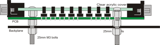

The exception to this is the switch board which, because the switches are relatively short, requires the spacers to be replaced with M3 lock nuts before the cover is put into place. This can be seen in the following diagram:
