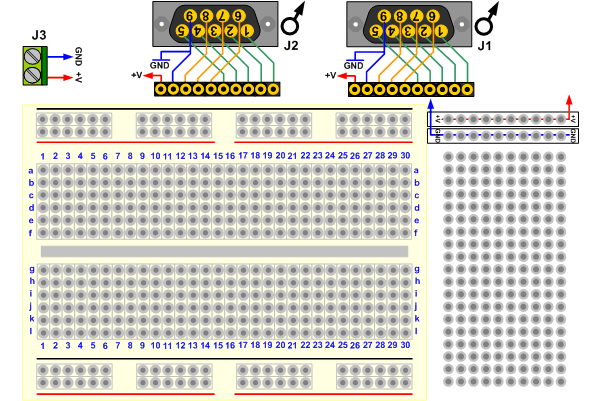

EB016 Prototype Board
More information can be found here.
EB016 Prototype Board Block Diagram
Which pins are connected to each other?
* Click EB016-30-1 for a datasheet. * The male D-type connectors fit into the Female connectors of an upstream board. * This board lets you build and test your own PICmicro circuits over and over again. * BE AWARE OF: ** the current limit per PIN of the PICmicro is 25mA. Stay well below this limit! ** Connecting input devices on pins that are configured as outputs (see switch board EB007) ** The total current limit of the PICmicro (all of the pins) is 200mA. * If you want a more permanent circuit built, or bad contacts in the prototype-board worry you, ** use the small Patch board and solder the circuit you want *To make connections easier you can use a special set of jumper leads which fit neatly into the turned pin connectors and into the proto board holes.

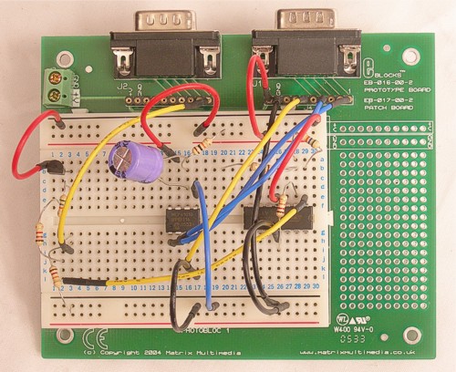

Example
