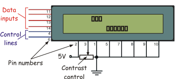

The LCD module is controlled by inputting instructions and data via the data inputs, and control signals, via the control lines. Instructions include clearing the display, moving the cursor back to the home position, and defining factors such as the number of display lines and character font. The control lines tell the module whether the signal on the data inputs is an instruction, or data, and enable the LCD module, allowing it to carry out the instructions.
On the PICmicro development board, the four data inputs lines and two control lines are connected to Port B of the PICmicro chip. (:nl:)(:table style="clear:both":)
