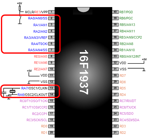

<^< 16F1937 Architecture | Course Index | PORT B >^>(:nl:) * All 8 pins of Port A can be used on a 16F1937 device * RA0-RA7 can be used as digital inputs * RA0-RA7 can be used as digital outputs * RA6-RA7 are often used for an external oscillator and may not be available as i/o * AN0-AN4 can be used as analogue inputs (=5 analogue inputs on port A)
* The pins of port A are mapped on the 16F1937 microcontroller as on this drawing
* The pins of Port A are connected to the 9-pin D-type connector of Port A on the Multiprogrammer board.
This port is connected to the rest of the PICmicro internals by an 8-bit bus system.
