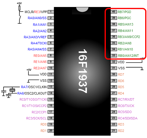

<^< PORT A | Course Index | PORT C >^>(:nl:) * All 8 pins of Port B can be used on a 16F1937 device * RB0-RB7 can be used as digital inputs * RB0-RB7 can be used as digital outputs * An external interrupt pin is possible on RB0 * An external IOC interrupt is possible on any of RB0-RB7 * AN8-AN13 can be used as analogue inputs (=6 analogue inputs on port B)
* The pins of Port B are mapped on the 16F1937 microcontroller as on this drawing
