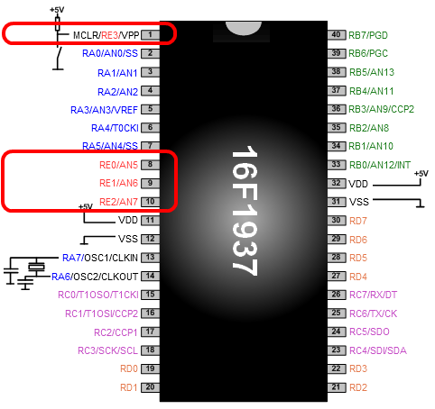

<^< PORT D | Course Index | Memory in the 16F1937 >^>(:nl:) * Only 4 pins of Port E can be used on a 16F1937 device * RE0-RE3 can be used as digital inputs * RE0-RE2 can be used as digital outputs (RE3 can be an input only) * RE3 is often used as the MCLR pin (i.e. reset) and may not be available to use as an input * AN5-AN7 can be used as analogue inputs (= 3 analogue inputs on port E)
* The pins of Port E are mapped on the 16F1937 microcontroller as on this drawing
* The pins of Port E are connected to the 9-pin D-type connector of Port E on the multiprogrammer board.
